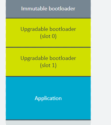

@Sarra.S thanks for your response. I have all the FOTA working using the MCUboot bootloader and FOTA libraries. Now what I am trying to do is upgrade bootloader image itself using FOTA not the firmware image(that is already working). In NRF(Nordic chips)devices they use two stage bootloader for the bootloader upgrade out of them first bootloader is immutable (fixed will not upgrade) the second bootloader is upgradeable using the first one.
I was wondering in STM32 do we have the same kind of mechanism for upgrading the bootloader image using FOTA or that is different. If it is different is there any documentation which I can refer to? if now then where can I get the first stage bootloader(immutable) for STM32u575
Something like shown in below image is the NRF chips mechanism for upgrading the bootloader image.

I did come across immutable bootloader which is in system memory. Is that what is required as first stage bootloader to upgrade second bootloader ( MCUboot from zephyr)?
