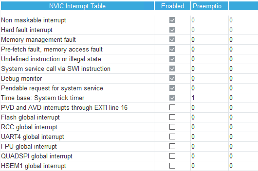

Others suggested that it may have to do with the NVIC SysTick priority having too low priority while it is called from a higher priority interrupt. So, I have disabled all unnecessary interrupts and kept the SysTick interrupt priority as follows.

0 is the highest priority interrupt. So set SysTick to 0 and all others above 0.
