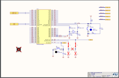

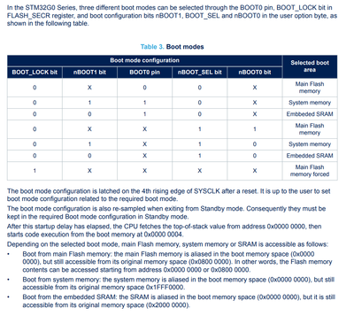

As we mentioned before, we do not use any pull-down resistor in this circuit. For this series of MCUs, there are three options for BOOT configuration:
We use the third option.
Additionally, for your information, we use the similar MCU in other projects without any external pull-down resistors and have never encountered any issues.
For this faulty PCB, I attempted to place a pull-down resistor to observe any effect. However, after connecting a pull-down resistor to Pin 25 (PA14), nothing changed—the MCU still freezes and does not operate!
I already checked the Device Errata and no similar issue found.

@Farhadpi wrote:As we mentioned before, we do not use any pull down resistor in this circuit.
Oh, according to your traces it's clearly doing something.
And as mentioned before, BOOT0 should always, always, always be pulled down (10K is fine) as a matter of good practice. If you intend to use the MCU's Bootloader or RAM start then a mechanism (usually a jumper to VDD) is needed to drive BOOT0 high.
As an aside, ST didn't do anyone any favors by combining BOOT0 and a debug pin. That was pure stupidity.

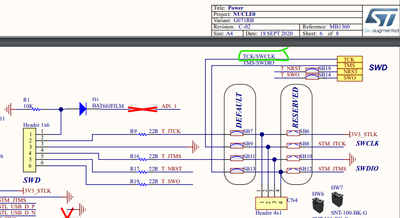

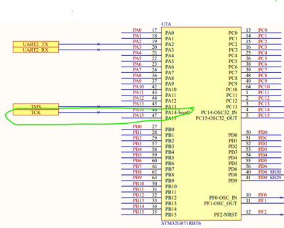

We placed a resistor temporarily to check if it would have an effect, but there is no dedicated place for such a resistor in the design.
As we mentioned earlier, we produced 1500 units and delivered them to our customer. Some of them failed after a couple of days or after a few charging cycles.
I think the discussion about the BOOT pin is irrelevant in this case. Even in the evaluation board from ST, "STM32 Nucleo-64 boards (MB1360)," does not use an external pull-down resistor on the BOOT pin. Therefore, this discussion should be concluded as it does not pertain to our issue.|

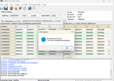

This is the screenshot of the ST-Link utility after comparing the faulty PCB flash memory:

PS. @David Littell : I see your point and generally subscribe to it, but the pulldown on BOOT0 may be not absolutely necessary if the options are consistently set to ignore that pin, would you agree?
2024-05-18 5:37 AM
@waclawek.jan wrote:...
Yes, absolutely agreed assuming they know what they're doing (for both hardware and software). Evidence of that isn't exactly overwhelming in this case. ;)
