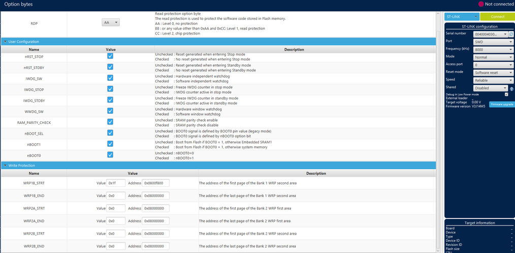

2024-05-17 12:49 AM
Please, find the option bytes from the below picture.
2024-05-17 2:04 AM
Is that what you expect, or what you read-out from a "failed" device?

2024-05-17 3:22 AM
Option bytes remains same for the failed and the working device. We did not see change in the Flash contents and the option bytes.

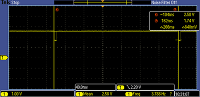

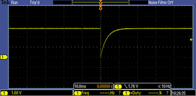

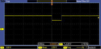

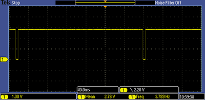

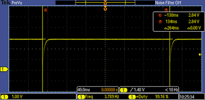

I measured some test points on the frozen MCU and observed that some pins are behaving oddly, like this:
1. NRST:
2. MCU_TX:
3. TP9/TP10
the rest of the Test Points like
| TP11/12/13/14/15/16/17/19 |
are low.

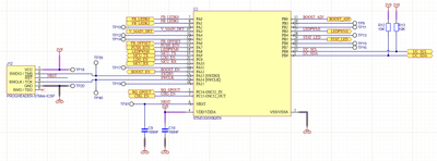

2024-05-17 5:02 AM
Is a pull-down resistor now installed at BOOT0? If no, why not?
Have you evaluated the Device Errata in the context of your problem?
