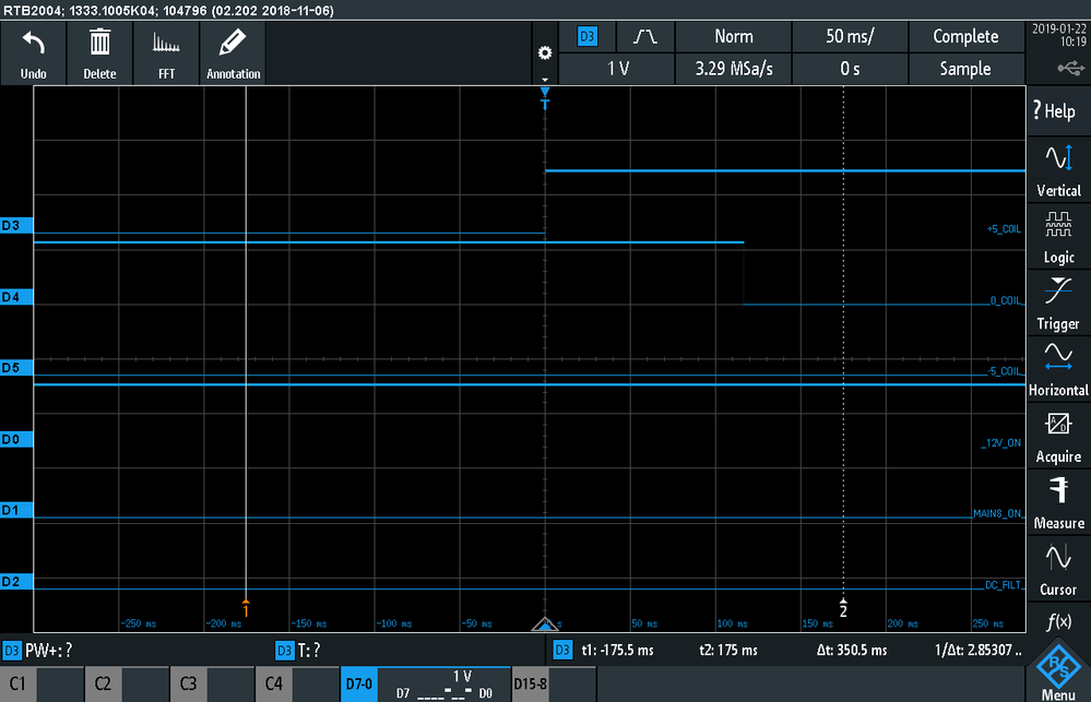

2019-01-22 1:25 AM
I have now checked the program run with a different oscilloscope and the errors are the same. After I have replaced the delay_TIM10(50) function with a while(!HAL_GPIO_ReadPin(_5_PLUS_COIL_GPIO_Port, _5_PLUS_COIL_Pin)); the oscilloscope's diagram looks correct except of the timings:
Approx. 117ms between just two simple register writes seems an awful lot to me. But in manual stepping this program code get's not interrupted by something else.
What Do you guys think could take so long? The HAL function?? I doubt that. The HAL routine looks clean and fast to me.

2019-01-22 6:05 AM
I must say I am really desperate :( . I don't understand why my processor is not doing as it should. I tried now several approches:
I tried using the HAL functions towrite to the appropriate output pin:
HAL_GPIO_WritePin(_5_PLUS_COIL_GPIO_Port,_5_PLUS_COIL_Pin,GPIO_PIN_SET);
HAL_GPIO_WritePin(_5_PLUS_COIL_GPIO_Port,_5_PLUS_COIL_Pin,GPIO_PIN_RESET);with this program exectution my oscilloscope gets not triggered at all, and I don't understand why. It's a 200MHz oscilloscope with digital probes...
Even if I put in a GPIO read, the oscilloscope gets not triggered:
HAL_GPIO_ReadPin(_5_PLUS_COIL_GPIO_Port, _5_PLUS_COIL_Pin);
HAL_GPIO_WritePin(_5_PLUS_COIL_GPIO_Port,_5_PLUS_COIL_Pin,GPIO_PIN_RESET);But when I put in the while statement, the oscilloscope triggers:
HAL_GPIO_WritePin(_5_PLUS_COIL_GPIO_Port,_5_PLUS_COIL_Pin,GPIO_PIN_RESET);the HIGH duration is approx. 100ms . This makes no sense to me at all if the MCLK is running at 64MHz.
I mean it cannot be that I have to put the __DMB() memory barrier between every IO operation. There has to be something completely messed up :(
