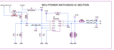

We are facing some challenge with external watchdog timer and STM32H7855xi. when there is no program in flash input to external watch dog timer (WDI) is output and no pulse . during this time external watch dog timer continuously generate reset pulse to microprocessor pin (nRST which is default of pull up) .
when we trying to program through JLINK pro external watch dog timer not allowing to program , it continuously resetting the processor , we need to manually separate external watch dog timer reset pin from nRST pin by removing R69 as per given schematic.
Do you have any suggestion to avoid manual intervention

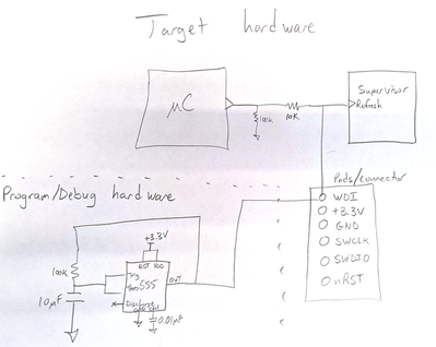

I am facing a similar problem and decided to solve it by adding a series resistor at the watchdog refresh pin then connecting that refresh pin to a spare pin on our debug/program connector and having an external oscillator continuously pulse that refresh pin to prevent reset while the debug adapter is connected. This effectively "defeats" the watchdog while the debug adapter is connected (also handy for being able to use breakpoints!) but not otherwise. (I also recommend using a direct/spring connector like SKEDD or TagConnect, but that's up to you.)
Relevant part of the circuit looks something like this:

That is also a solution, though in some cases this has unwanted side-effects, such as when the SWD pins are used for other functions in application and require a hardware reset from the debugger/programmer to be able to use to reprogram.
