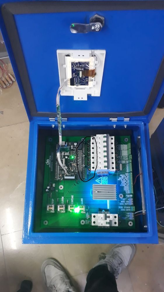

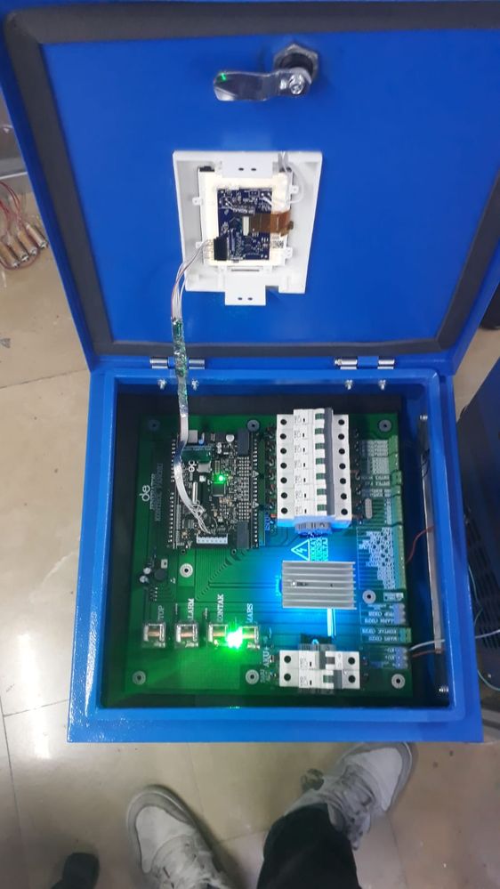

in the pic the black board is the controller board the blue one is the tft controller
the Contactor is in a different place

I suspect than High voltage line 110-250VAC is routed on PCB backplane ? Can you confirm ?
What is the type of load powered by High Voltage ?
You need to add a AC filter on high voltage.
And check your decoupling capacitor circuit before and after the LDO regulator.

the high volatge is routed on the top-plane (cheak the pic )
the problem start happening after we decided to separate the tft from the black board

Maybe interference in the flat SPI cable generated by High Voltage.
Try also to replace flat SPI wire by shielded cable and route it away from all power source (on the left from picture)
