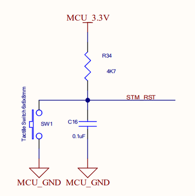

2026-03-30 2:49 AM - edited 2026-03-30 3:13 AM
The schematic does already have that.
The suggestion is to try it to see if it makes any difference

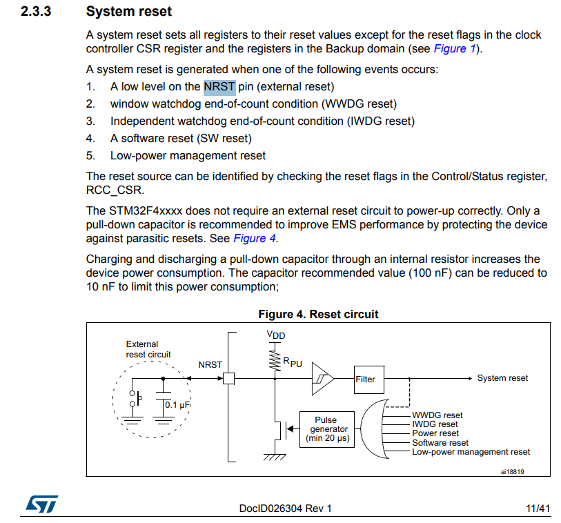

From the posted schematic:
From the STM32F4 Hardware Design Guide:
http://nic.vajn.icu/PDF/STMicro/ARM/STM32F4/STM32F4xx_Hardware_Dev.pdf#page=11
Which recommends no external pullup.

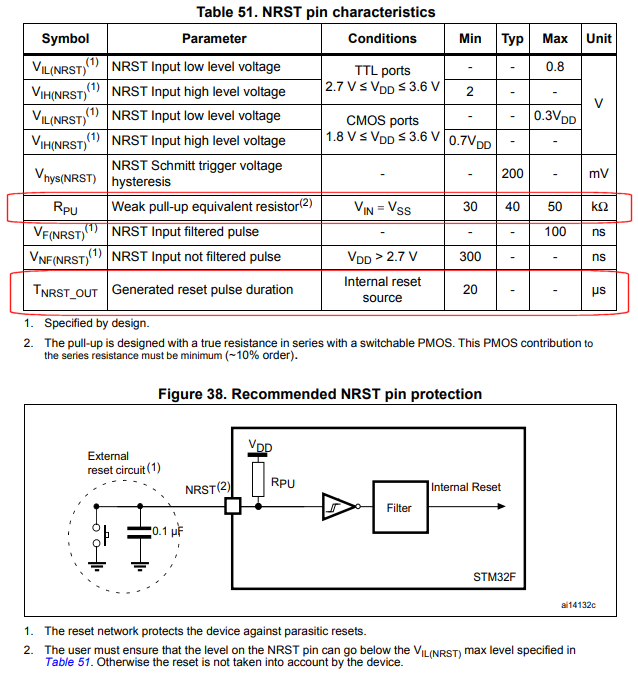

This is repeated in the datasheet:
https://www.st.com/resource/en/datasheet/stm32f407ve.pdf#page=120
Although an external pullup is generally not considered harmful, the 4k7 shown seems a bit low - so maybe it's giving a too-short pulse ... ?

But the STM32 documentation recommends 0.1uf with just the ~40k internal pullup - so adding an external pullup of just 4k7 could well give a too-short reset pulse...

I have implement the 47K pull-up and 0.1uf cap on NRST pin. But waveform is not captured. its goes to low, when button pressed. However I will check again.
