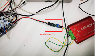

2024-04-18 8:17 PM
Thand you for your reply
I find the cause of the problem
The transceiver need to power of 5V, but I only provide 3.3V

Are you using a transceiver with another CAN node connected to the bus?
1. had can transceiver

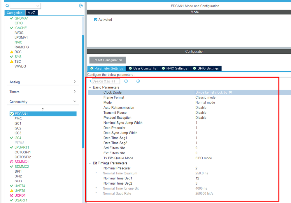

2024-04-17 7:16 PM - last edited on 2024-04-18 3:36 AM by mƎALLEm
I change below,but it doesn't work too
hfdcan1.Instance = FDCAN1;
hfdcan1.Init.ClockDivider = FDCAN_CLOCK_DIV10;
hfdcan1.Init.FrameFormat = FDCAN_FRAME_CLASSIC;
hfdcan1.Init.Mode = FDCAN_MODE_NORMAL;
hfdcan1.Init.AutoRetransmission = DISABLE;
hfdcan1.Init.TransmitPause = DISABLE;
hfdcan1.Init.ProtocolException = DISABLE;
hfdcan1.Init.NominalPrescaler = 2;
hfdcan1.Init.NominalSyncJumpWidth = 1;
hfdcan1.Init.NominalTimeSeg1 = 12;
hfdcan1.Init.NominalTimeSeg2 = 3;
hfdcan1.Init.DataPrescaler = 1;
hfdcan1.Init.DataSyncJumpWidth = 1;
hfdcan1.Init.DataTimeSeg1 = 1;
hfdcan1.Init.DataTimeSeg2 = 1;
hfdcan1.Init.StdFiltersNbr = 0;
hfdcan1.Init.ExtFiltersNbr = 0;2024-04-18 3:21 AM - edited 2024-04-18 3:40 AM
