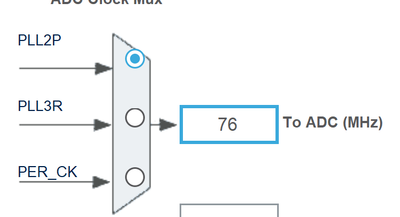

The clock for the ADC is configured as 76 MHZ. Does that mean that 1 ADC cycle is 0.013 uS (1/76M) ?

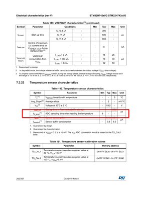

The datasheet says that the minimum sampling time should be greater than the stabilization time, but I am not bale to find the stabilization time. Could you please tell me the minimum sampling time I should set to read reliable temperature values ?

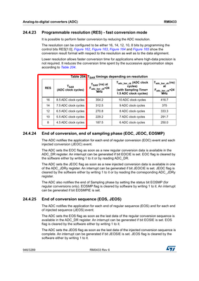

From the datasheet, the total time for conversion is given by the formula: "sampling time + 7.5 ADC cycles."

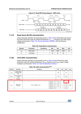

No, there's an additional prescaler, ADCx_CCR.PRESC. You should not set it so that ADC clock is 76MHz as maximum ADC clock is 50MHz (with appropriately set BOOST bits -- in rev.Y the max. ADC clock is lower).
That's unfortunately misleading and valid only if you select 14-bit conversions. The conversion time depends on selected resolution (and also if the sampling time was selected the shortest 1.5cycle or not):

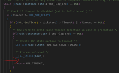

Yes, The error code returned is 0x03 which is HAL_TIMEOUT.
This is returned from the point marked below and the value of ISR and ADC3_CSR is same which is 0x1003.
This means that the EOC flag is not set.

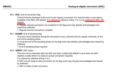

Should not. While the debugger is part of the processor and shares its bus system, transactions through it should be rare relatively to the overall performance of the processor, as commands/data to/from the on-chip debugger to the "debugging pod" traverse through a relatively slow serial interface (SWD).
However, while *timing* may not be affected significantly, reading registers through the debugger does have consequences: in your case, reading ADC registers, namely ADC_DR, using the debugger, clears the EOC bit:
