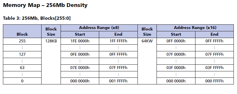

the FMC bus having address bus of 24 bits, by using which we can interface & access M29W256 (256 block memory)
Does it possible to access more memory space, either by changing block size or using M29W512 device on same address bus?
