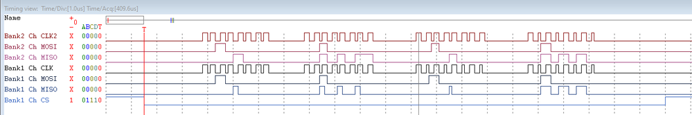

I also analyzed the Physical SPI interface this seems to work Fine.

From your last plot, it doesn't appear that either interface is sending only 1s. I see 0s and 1s in both MOSI and both MISO signals. Can you clarify what the problem actually is?
TOne.1
Associate II
I want to measure a voltage with ADC. The Last 12 Bits in the Plot are the measured voltage. So both ADC get the same Analog reference Voltage and Test voltage. So the communication should give the same values back. At least almost noise in the last bits is ok. but at the moment the SPI1(Master) Interface delivers the right voltage 1000 0001 1010 which is 2.531V. The SPI2 should deliver the same sequence and in the plot the IC does deliver the same sequence of bits. But when I run my code the " buf4[Buf_Idn] = *(__IO uint16_t *)&hspi2.Instance->DR;" call delivers 1111 1111 1111 so where does this difference come from.
