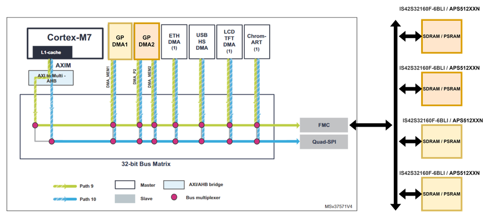

Here is a figure which shows the system architecture with the help of the graphic from application note AN4667.

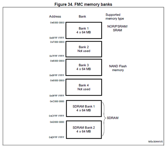

From the reference manual RM0431, we found following FMC memory bank map:

  • Is this system architecture possible at all?
  • Could we use 4 blocks(64MByte) of PSRAM or also 4 Blocks(64MByte) of SDRAM?
  • What are the benfits of SDRAM over PSRAM (which one is better for what?)
  • Does it make sense, that two memory blocks are controlled over DM1 and the other two over DM2?
  • So we can Read from one of the first two with DM1 and at the same time write to one of the oder two with DM2?
  • What constraints do we need to consider when choosing the right RAM ic?
  • Would the IS42S32160F-6BLI (SDRAM) or APS512XXN (PSRAM) both fit to the FMC of the M7 MCU?

Unfortunately, the architecture proposed is not possible. As referenced in RM0431, Bank 4 and 5 used to address SDRAM devices (1 device per bank).

But with the PSRAM it should be not? In RM0431, on page 274 it is written following:
  • From the FMC point of view, the external memory is divided into fixed-size banks of 256Mbytes each (see Figure34): • Bank 1 used to address up to 4 NOR Flash memory or PSRAM devices. This bank is split into 4 NOR/PSRAM subbanks with 4 dedicated chip selects, as follows:
    Bank 1 - NOR/PSRAM 1
    Bank 1 - NOR/PSRAM 2
    Bank 1 - NOR/PSRAM 3
    Bank 1 - NOR/PSRAM 4
I interpret this to imply that we can attach 4 external 64MByte PSRAM to the FMC bus.
What do I misunderstand?

  1. Each controller (SDRAM controller or PSRAM/NOR controller or NAND controller) has its signals and its configuration interface. Refer to figure 33 in the reference manual.
  2. It is possible to swap the mapping using SWP_FMC bit field in SYSCFG_MEMRMP register. However, you cannot use 4 SDRAM devices at the same time.
    So, SDRAM bank1 and bank2 can be mapped at 0x6000 0000 and 0x7000 0000, but respectively NOR/PSRAM bank is mapped at 0xC000 0000 necessarily.
  3. Each SDRAM Bank can support memory devices with up to 4 internal Banks. But each bank has independent Chip Select and independent configuration.

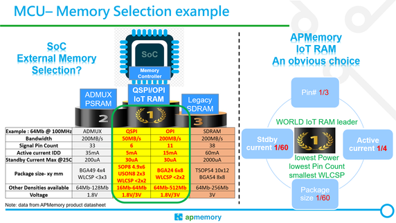

Few comments about PSRAM
APS512XXN is an Octal / Hexa RAM and is not supported on F7 / FMC memory controller, but would be most effective solution on SMT32H7,U5, H5, L5, L4+... for example. Key advantage of QSPI/OPI/HPI PSRAM versus legacy SDRAM are pin count, power, simplicity of design, space saving and especially for Hexa PSRAM versus SDRAMx32 competitiveness. Some illustrations at following links:  https://www.st.com/en/partner-products-and-services/iot-ram-opi-psram.html and https://www.st.com/en/partner-products-and-services/iot-ram-hpi-opi-psram.html
- You can see some comparison of SDRAM/ADMUX PSRAM (FMC Memory controller) and OPI/QSPI PSRAM (Octal memory controller)
Alex

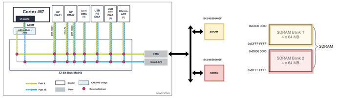

Dear @Alex - APMemory  & @FBL
Thank you immensely for your assistance. Due to your help, we've been able to modify our requirements to a maximum RAM of 72 MBytes.
The revised architecture is as follows:
As a controller we still stick to the STMF32F723 controller
We plan to use the IS42/45S86400F, which has an internal design featuring 16M x 8 x 4 banks. Unfortunately, my search for SDRAM chips did not yield any options with 128MByte or 256MByte capacities. Are any of you aware of SDRAM chips that offer these higher memory sizes? Utilizing a single chip with a higher capacity would significantly simplify both hardware and firmware development.
Best regards, Corsin Obrist

I can't see from your pic if you still stick to the F7. Be careful with that one concerning QSPI memory - it works, but not in memory mapped mode.
CObri.1
Associate III
Hi @LCE ,
Yes we still use the STMF32F723 controller.
So the two RAM Chips can be accessed (written/readout) over the FMC bus?
Best regards
Corsin
Sorry, I have never used FMC.
I just had the (bad) experience that memory mapped read & write was not possible with a F767 and a QSPI RAM.
