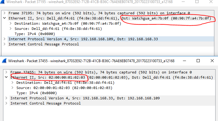

This morning I found some times when I ping the device, the MAC address is not the address of my device
