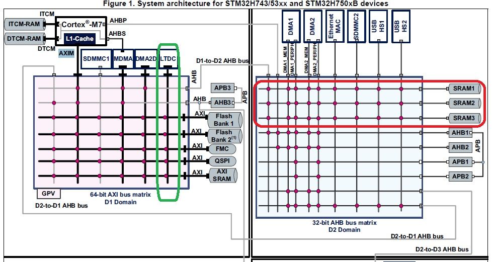

What RAM?
The LTDC needs the data in the AXIM RAM

>>Do I need RAM_D1 or RAM_D2 or RAM_D3?
The AXIM SRAM is in the D1 Domain, so RAM_D1

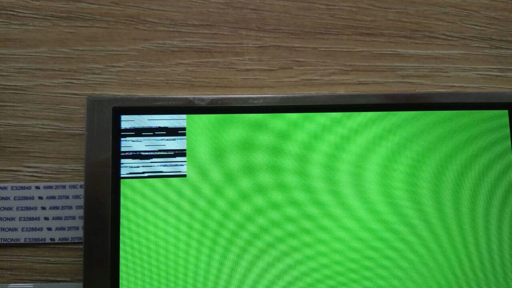

2018-12-10 1:30 AM
Thank you.
I have a result.
I copied the linker script from the project "Mdma_linkedlist ".
I fill the square with white and black once a second and here's the result.
Perhaps I should just use an external SDRAM? It'll take time, but I'd have to do it anyway.
