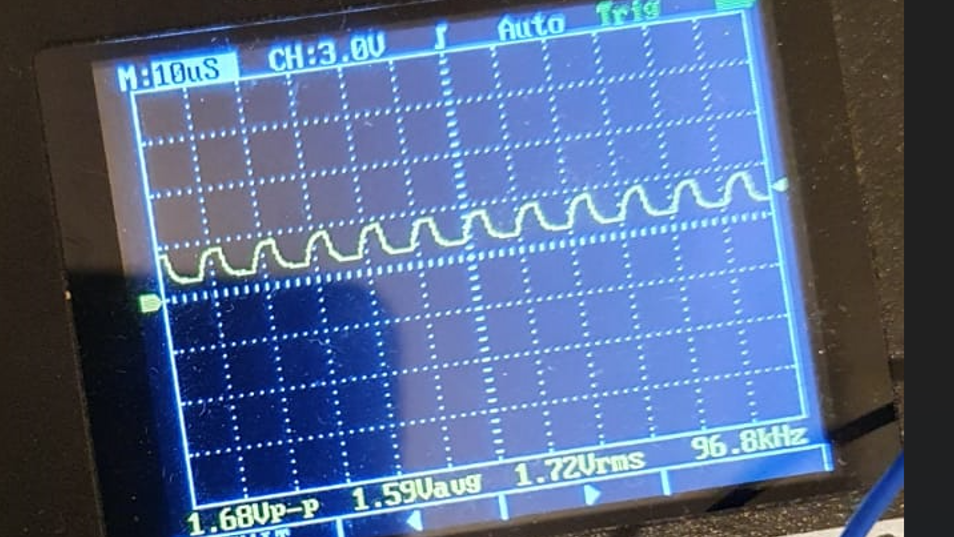

2022-06-22 9:28 AM
Thanks for the comment!
I looked at the signal yesterday and it seems ok. I'll upload a picture later cause I don't have enough hands at the moment:)
Eyal
2022-06-22 9:53 AM
Also, from what I see in the scope the read data is correct
