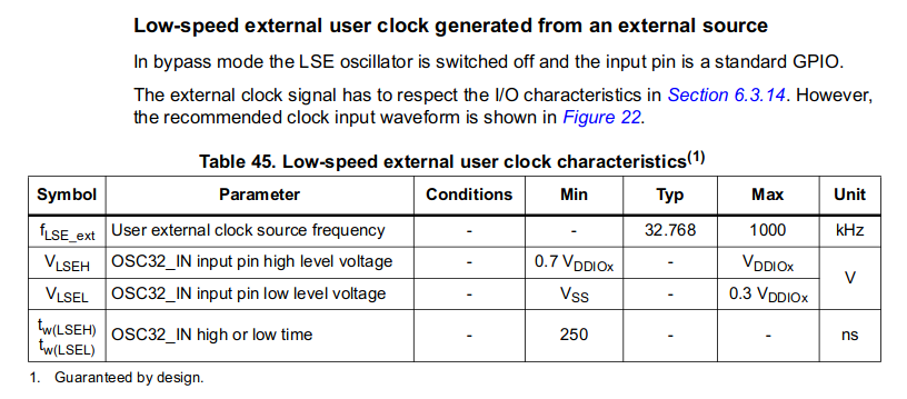

The datasheet specifies 1 to 1000 kHz as external LSE, But with 1 khz thi will also be about 2.5 seconds, a substantial delay.
2019-05-09 8:07 AM
4 seconds at 1 KHz ;)
where did you find 1KHz as minimum freq. for LSE?
in STM32L431xx datasheet, it mentions no minimum limit for LSE freq. in bypass mode
(page 115)
