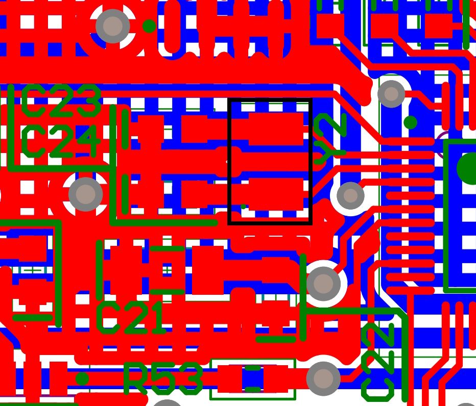

I think that it maybe about PCB Layout but it just maybe, I'm not sure that I need to prove it by check OSC signal with Oscilloscope later.
But I don't think a LSE design guide is very strict that I think it should be good enough to operate.
and I had check a power supply that it work fine.
I have to find out what is the root-cause.

Ok, it's too complicate.
I had 5 boards and it's only single one it can solved by cleaning a PCB by solvent.
And the other board, they are not work fine.
So I think that I have to re-design this board with very restrict to follow AN2867
Oscillator design guide for STM8AF/AL/S, STM32 MCUs and MPUs - Application note
And if it's work fine that I will update later.
