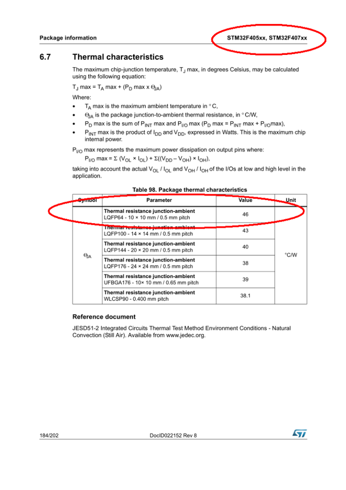

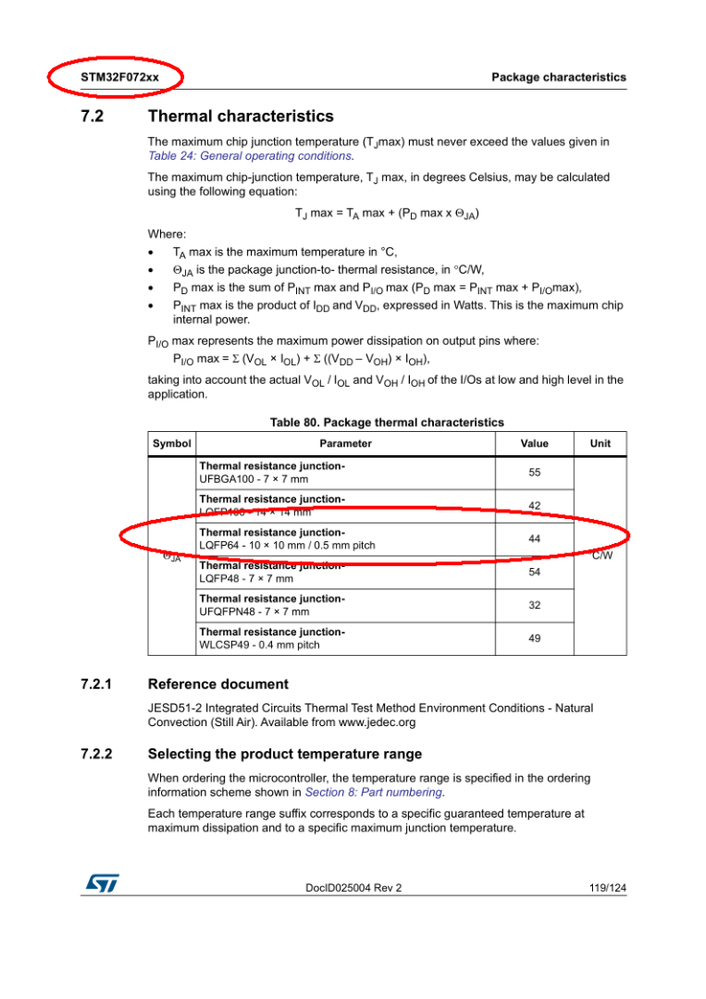

I didn't find it particularly difficult to find; it's simply in the DS for the given model. Not that surprisingly, it's (slightly) dependent on particularities of each chip, not just the package itself. Two randomly selected examples:
