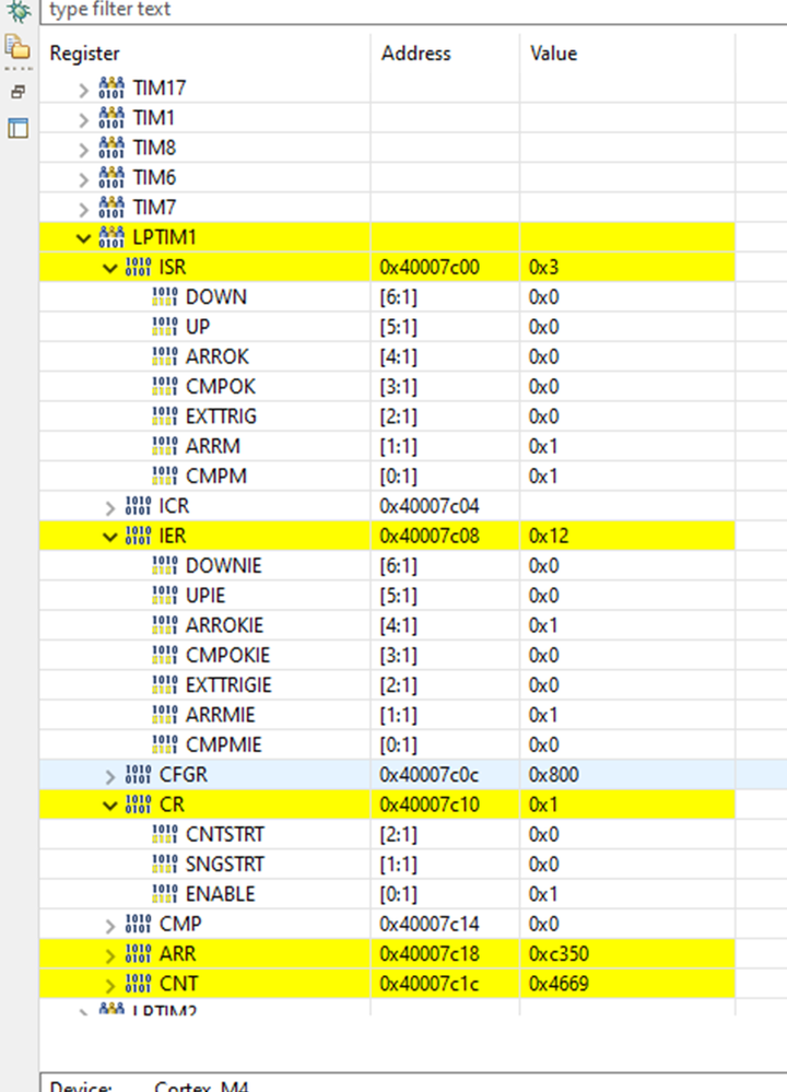

I am trying to create a 50ms timer using the above reference. The clock is 16MHz, I have a divisor of 16 and have the NVIC enabled (all this is done in cubeMX). I have the following ISR
void HAL_LPTIM_AutoReloadMatchCallback(LPTIM_HandleTypeDef *hlptim)
hlptim1.Instance->ISR |= (LPTIM_ICR_ARRMCF | LPTIM_ICR_CMPMCF);
}Prior to the while 1 loop I call:
HAL_LPTIM_Counter_Start_IT(&hlptim1, 50000);It doesn't appear to me to be working correctly.....At start up I get into the ISR and count is way less than it should be....Can someone tell me what I am doing wrong? This should be pretty simple as I just want the timer to count to 50ms (using 16mhz with /16) and every time it rolls generate an IRQ....

Turns out the timer was being clocked at some very slow rate as another FW person touched it ....This has been solved...Thank you
Is LPTIM stopped upon breakpoint in its respective DBGMCU freeze register?
2022-05-27 11:32 AM
