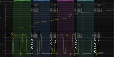

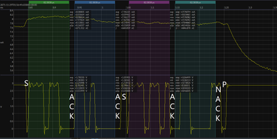

From the I2C3_SDA zoom-in, I would expect to get a STOP at the end of the transmission which is not the case.
2023-11-28 6:14 PM
Hi @Sarra.S ,
Thank you for the reply. I don't think an I2C STOP bit is missed there. The attached snapshots are the SDA waveform of the same communication using I2C3 with the external sensor under MCU RUN mode and MCU LPBAM mode, and I've sectionized and labelled the waveform. PS: the only difference is that in RUN mode I was using HAL_I2C_Mem_Read and in LPBAM mode I was using Master transmit followed by a Master receive.
