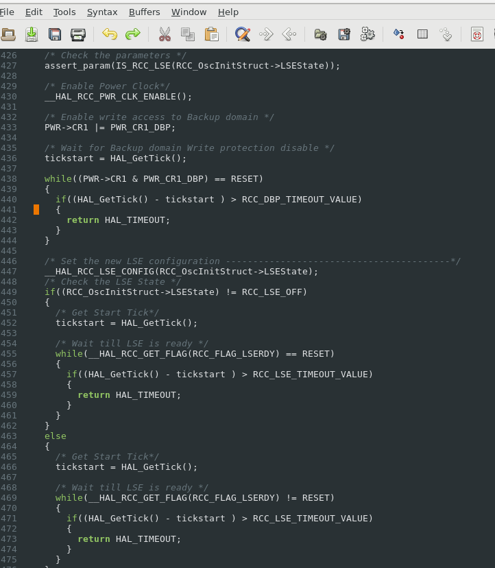

If you take a look into the ST code, there is a wait loop right after you enable the write access to backup domain. It can happen that you are configuring the LSEON bit while you can't...
I know you mentioned you are stepping through the code, but maybe...

Good point. I'll try putting in some delays and see if that helps.
