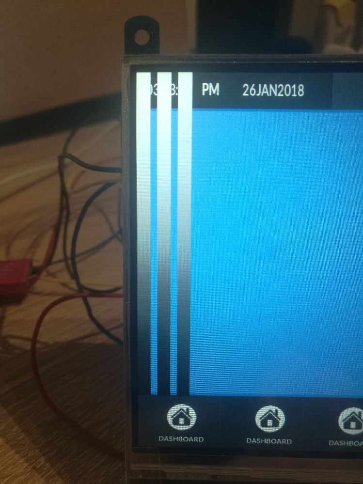

I've been working on a simple UI library for my project.
I'm using the stm32F7 with LTDC configured to RGB888 color space.
Whilst I was writing a color gradient function, I noticed that my gradients looked 'choppy'
Left gradient: Dithered RGB888 bitmap
Middle gradient: non-dithered RGB888 bitmap
Right gradient: custom gradient function

Based on my calculations, I have a 600px high display and I am drawing a full-height gradient. I expect a different color value every ~2.35 lines (600 lines / 255 grey shades). However, my display shows a color change every ~9 lines.
Does anybody have an idea where I shall start looking for the cause?
I am using DMA to draw the two bitmaps, with the appropriate input color modes for both bitmaps.
For gradient I just use a simple register to memory call for each line.
2018-02-11 10:38 PM
Assuming you have verified your gradient bar code in general, I suggest to draw larger blocks (rectangles) of different/adjacent colors side by side.
Single pixels or lines could be difficult to discern.
And don't forget, color perception is highly subjective in general.
