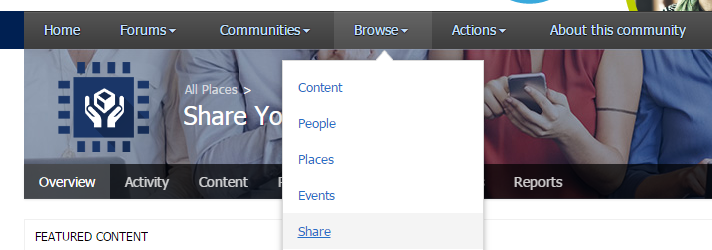

You can share your project in the community by clicking onBrowse >> Share >> Share your project (in the right)
