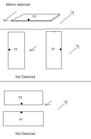

1 Write A7h into CTRL_REG1// Turn on the sensor and enable X, Y, and Z// ODR = 100 Hz2 Write 00h into CTRL_REG2 // High-pass filter disabled3 Write 40h into CTRL_REG3 // Interrupt driven to INT1 pad4 Write 00h into CTRL_REG4 // FS = 2 g5 Write 08h into CTRL_REG5 // Interrupt latched6 Write10h into INT1_THS // Threshold = 250 mg7 Write 00h into INT1_DURATION // Duration = 08 Write 0Ah into INT1_CFG // Enable XH and YH interrupt generation In my case interrupts are not latched so 00h in CTRL_REG5I am getting these interrupt on INT2 and not INT1 pin , i can see the interrupts coming on INT1 in scope , but they dont generate a GPIO inerrupt on MC ,perhaps some problem with board , but when INT2 is enabled ( 0x40h in CTRL_REG6 of Accelerometer) i will get same signal on INT2 and INT1 perhaps same signal is duplicated on INT2 and i get this on GPIO interrupts ,so far its detecting motion only when the PCB board is oriented in a position parallel to earths surface , but when it is kept vertical and moved along x or y axis no interrupts are generated .2015-04-10 7:32 AM
