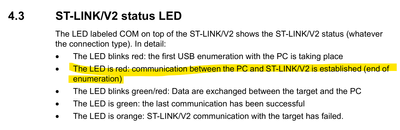

Hello, I am wondering why the led (LD10) stays red on the board after plugging in a micro USB cable to power it on (thus I assume that's the reason the screen stays black).
The USB cable is connected to the board (CN2 ST-LINK V3 port) and to a laptop on the other end. The JP6 jumper is on STIk on the back. See the attached pictures for details. Is there anything I did wrong ? Or should I launch something else to make the LED green?
2024-07-11 12:35 PM
LD10 being solid red is correct behavior. It indicates the USB has been connected and enumerated.
As for why the screen is black, must not be a program on the board that uses the screen. Has it ever worked? Was the chip erased? Can STM32CubeProgrammer connect, and if so, is the flash programmed?
