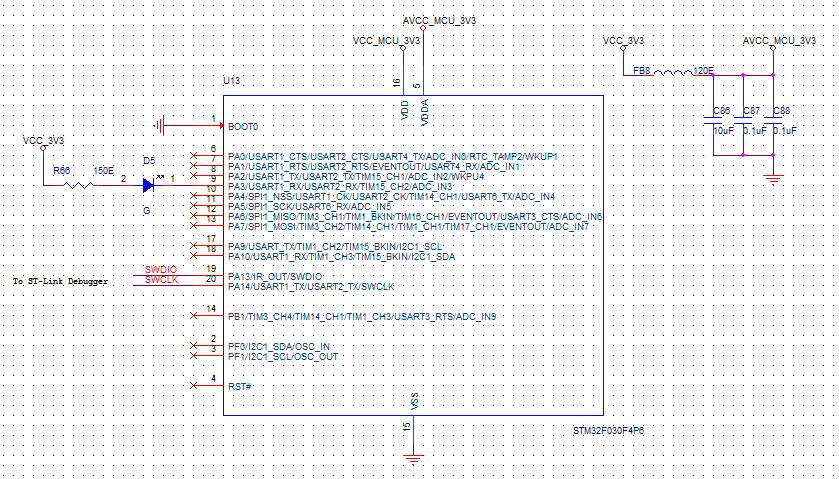

2017-08-11 6:40 AM
Yes, but there's no VSSA on the TSSOP20 package.

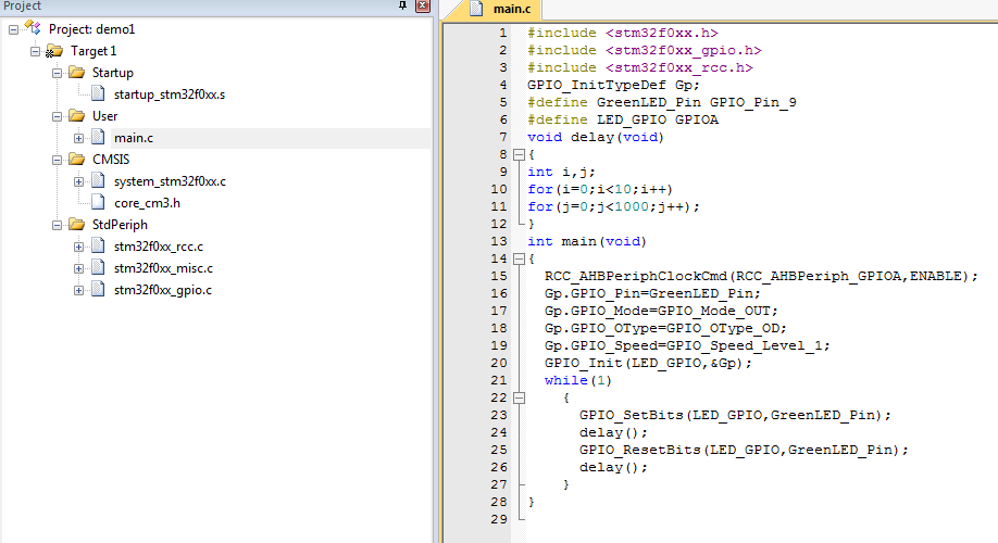

2017-08-11 1:30 AM
The above is my circuit and program. Hope added all library and everything. But I'm unable to make it work in STM32 MCU. Is there anything need to be done in addition to it?
