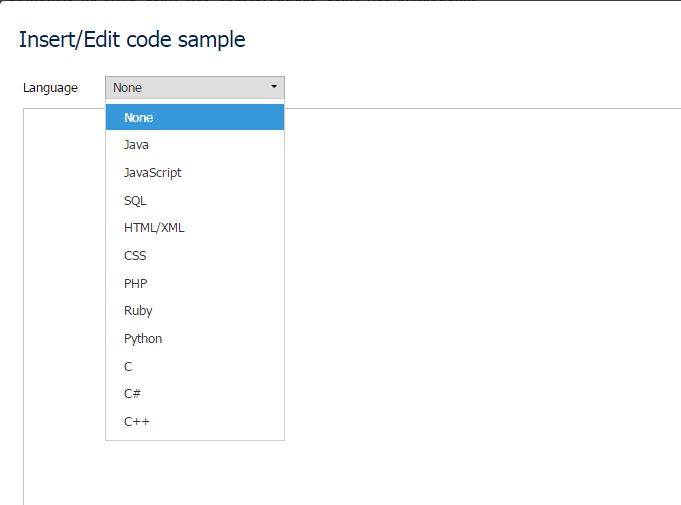

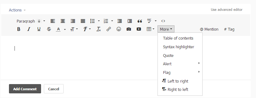

ou should expand toolbar by clicking on [...
] icon :Click on ''More >> Syntax Highlighter'' :
Then, insert your code in the appropriatelanguage:
