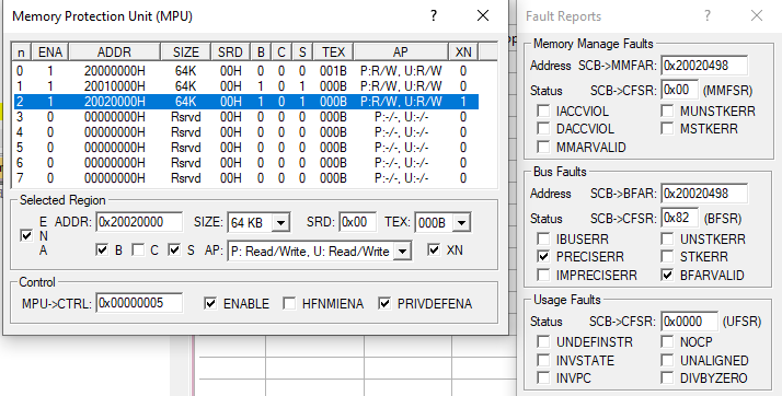

That cannot be the reason since I have set up memory accessed by LDREX as Device memory in this case and according to ST's application note AN4838 to prevent speculative prefetch, memory should be set up as Strongly-Ordered or Device and I tried both combinations but when Shared attribute is set (which should be set for both of these types) LDREX produced hard fault (actually bus fault) as in the picture

I don't think LDREX/STREX to device (or strongly-ordered) memory is supported.
From ARMv7-M ARM A3.4.5 Load-Exclusive and Store-Exclusive usage restrictions:
"LDREX and STREX operations must be performed only on memory with the Normal memory attribute."

I've also run into this problem on the STM32H755. I suspect that the STM32H7 AXI bus matrix does not implement a global exclusive monitor, given that it doesn't support hardware coherency. From https://www.st.com/resource/en/application_note/dm00272912-managing-memory-protection-unit-in-stm32-mcus-stmicroelectronics.pdf (emphasis mine):
"The S field is for a shareable memory region: the memory system provides data synchronization between bus masters in a system with multiple bus masters, for example, a processor with a DMA controller. A strongly-ordered memory is always shareable. If multiple bus masters can access a non-shareable memory region, the software must ensure the data coherency between the bus masters. The STM32F7 Series and STM32H7 Series do not support hardware coherency."
I scoured the reference manual, datasheet, and several application notes[1] and found no mention of a missing global exclusive monitor — a glaring omission.
In testing, I found that stores issued on the M4 core would not clear exclusive locks acquired by the M7 core, and vice versa. In other words, I couldn't get std::atomic<uint32_t>::compare_exchange_weak() on one core to fail when the other core was simultaneously storing to the same location. I've taken that to mean that the C++ std::atomic synchronization primitives are unusable on this platform, and instead one must explore alternative algorithms or consider using the hardware semaphore (HSEM) peripheral.
If ST is monitoring this post, would you please confirm that the STM32H7 does not implement a global exclusive monitor?

Thanks for that, it does completely explain my findings.
