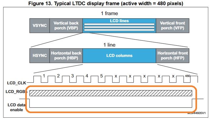

Secondly, In reference manual, for table 260, LCDT pins and signal interface. Signal LCD_DE is denoted "Not data enable". I guess but will verify that this means a inverted signal. i,e, active low? I mean, it is not an statement saying that this is "absolutely not Data Enable", and that the real purpose of this signal is not revealed.. right? Reason for asking is that my display is opposite, and I need to know if I must put in an inverter here.
2018-09-16 5:04 PM
Low when RGB Data is valid
Look the code examples for the EVAL board, perhaps have the code run on a NUCLEO (or EVAL) and probe the signals with a scope or logic analyzer so you can visualize exactly what is happening, the relationship between the signals, and your ability to control them.
