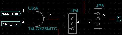

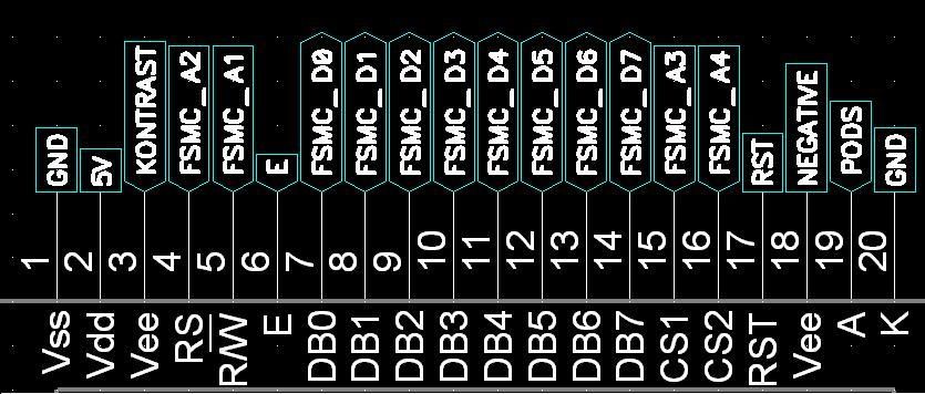

I post schematic diagram, as you can see I use addresses lines to set RS, RW and other control signals. I hope to have only one instruction to control the display.
I will give you information if I will have a success :)2011-05-17 3:44 AM
Very nice drawing. Have concern that ''NWE'' and ''NOE'' (which are nand'ed to form positive going ''E'' strobe) are NOT qualified by an address decode - thus you will generate ''E'' illegally!
Sorry if I've missed something - we used to generate unique address - decode it - and then gate that adr. decode with WR or RD to produce ''E.'' That unique adr. decode is what I don't yet see/understand in your drawing. Trying to prevent you from a hacked pcb... Your goal of a ''single'' instruction display write will take our FSMC ''Forward to the Past!'' (way neater than: 1) present RS, RW; 2) present latched data; 3) strobe E high; 4) take E back low - this tired way is so inefficient/uninspired...) [ This message was edited by: jj.sprague on 07-09-2008 15:06 ]2011-05-17 3:44 AM
Quote:
Have concern that ''NWE'' and ''NOE'' (which are nand'ed to form positive going ''E'' strobe) are NOT qualified by an address decode - thus you will generate ''E'' illegally! Thanks for showing me that problem. I thought that FSMC generate WR/RD signal only if I write or read form addresses of memory that belongs to FSMC. Now, I understand why ST uses hardware NE1 as chip select. I will reconsider this solution (try to explain my boss that is not worth to do that) and maybe back to the standard solution - steering all signals using GPIO. Do you think it is worth to do that using FSMC? [ This message was edited by: jaroslaw.oska on 07-09-2008 16:35 ]2011-05-17 3:44 AM
