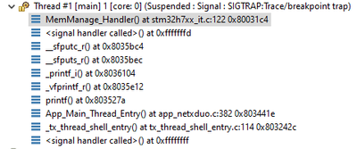

I have a project using STM32H743 and Azure RTOS, ThreadX, NetX, and FileX.
In the NetX portion during initialization of the netx thread, the code performs initiation of the LAN8742 device.
Here is the call stack tree in the debugger:
The hard fault occurs on line 131 in the lan8742.c code which is :
if(pObj->IO.WriteReg(pObj->DevAddr, LAN8742_BCR, LAN8742_BCR_SOFT_RESET) >= 0)
The Status registers show:
The fault is 100% repeatable.
The fault appeared after adding some code to a completely unrelated section
and the fault happens prior to any of the added code being executed. As far as I can tell
The only difference is that the added code has pushed the LAN8742.c code a
little farther down in the flash. I also noticed that some of the printf()'s for debug also
cause issues like mem faults and have to be commented out. I am not finished experimentation
with what causes the hard fault in the Lan8742 code but any comments at this pint are welcome.

I kept adding printf statements until the error occurred again. This time it ends up in the mem_manage handler. The fault repeats on every run. Commenting out the Cache Enables for I and D, one at a time, and then both, does not change the location of the error or error type. The call stack is always:
Lacking patience for this I guess I am going to make my own terminal debug functions and put them in a thread. Hopefully it will be a little behaved.
