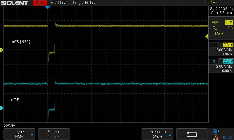

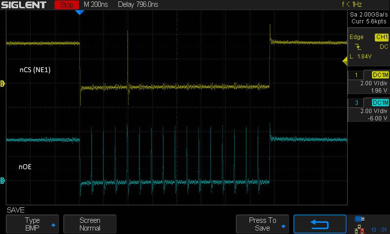

I'm using a STM32F765 clocked at 216MHz and when D-Cache is enabled it badly affects reads from a device connected via the external FMC address/data bus (NE1, 16 bit data, 10 bit address). The following pictures show the problem (note ringing is caused by non-optimum scope lead grounding)
D-Cache On:
D-Cache off (expected result & same time base as above):

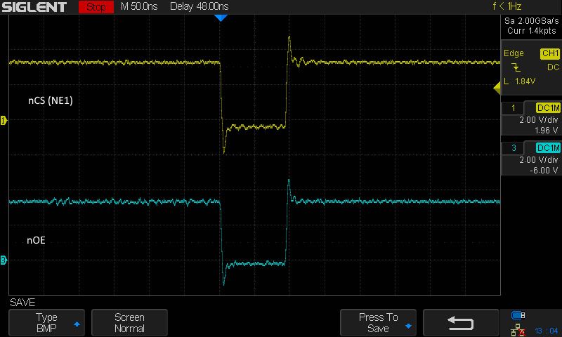

D-Cache off (expected result, zoomed in)

2019-12-27 6:19 AM
So what does "badly affects reads" actually mean?
Looks to be doing 16 operations for the cache-line.

2019-12-27 9:28 AM
Thanks berendi, your 2nd sugestion worked a treat!
I'd still like to know why data caching causes 16 reads for a single FMC read request if anyone has any insights.
Dave
2019-12-27 9:05 PM
Cache cotrollers work that way.
The Cortex-M7 cache is organized into lines (sometimes called rows) that are 32 bytes long. A cache line is either filled or empty (invalid), there is no partially filled line. A read request from a cacheable memory area allocates a cache line and fills it with data. This works great with NAND and DRAM type memories that are organized in rows as well, e.g. if one memory cell of a DRAM is accessed, subsequent accesses to cells in the same row are faster, because the "row is opened", so the cache controller can read the rest of the line fast.
