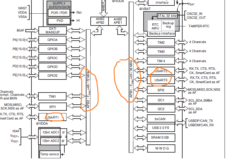

Thank you for your response,
Following the block diagram the microcontroller, USART1 is on APB2 bus -->72MHz, USART2 and USART3 are on APB1 bus -->36Mhz.
the reason why i'm suspecting Keil : USART2 is working perfectly, but usart3 which is on the same bus, so logically use the same BRR, doesn't work, i have activate the clock for USART3 and the other small modifications, but the problem is still here, nothing is printed.
