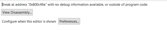

Thats weird because
>>The first line "tickstart = HAL_GetTick();" jumps to fault handler
HAL_GetTick just returns that variable
__weak uint32_t HAL_GetTick(void)
return uwTick;
}If i were you i would start all over again fresh CubeMX project, only the XTAL and make sure hal_delay is working , keep adding stuff untill it breaks again.
2023-01-11 7:05 AM
Now the second line SET_BIT(RCC->CR, RCC_CR_HSION) jumps to fault handler.

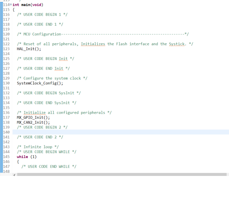

2023-01-12 5:36 AM
I made .ioc file for bootloader as the same as .ioc file for the application, and HAL_RCC_deinit() didn't jump to hard fault.
But the last line of the jump function Jump_To_Application() jumps now to hard fault interrupt.
