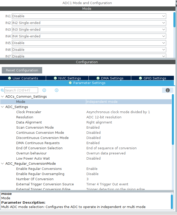

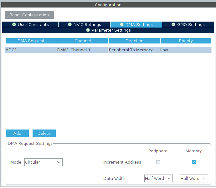

I've configured 3 ADC channels (IN2, IN3,IN4) in DMA mode (device=STM32L475RCTX running at 80MHz) as shown:

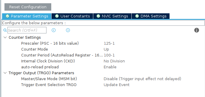

I want to set a sample time of 6400Hz (156.25ms) so here's the TIM4 configuration

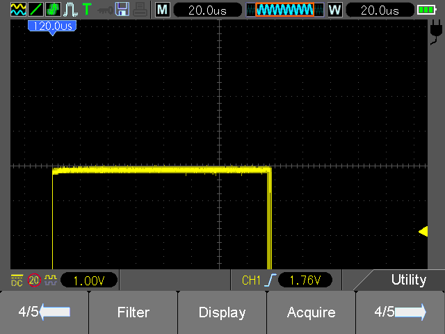

In order to test the sample time I toggle an output pin in the irq callback:
Everything is okay except for the jitter on this output:
This jitter is about of 5us. Why? How can avoid this? I've tried to change the DMA priority interrupt without success.

If you toggle a pin in ISR (DMA Transfer Complete), then the jitter may come from both the DMA's transfer being influenced by collisions on the bus, and - probably more importantly - jitter of the interrupt's latency. This does not mean, the ADC is jittery.

The ADC is configured in asynchronous mode. In the reference manual RM0351 on the page 510, the note tells you that if you want to have no jitter, then you need the synchronous option. The reference manual for the F0 family is clearer on this point.
So what you see is the jitter on the start of the conversion, maybe with a mix of the ISR of ADCConvCplt execution jitter as @Community member suggested.

Hi Kraal,
I've changed the ADC mode to synchronous and the jitter (on toggled GPIO) is reduced to 1.6us.
