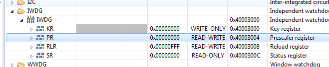

) in the page 712 sais that minimum timeout are 0,125us if it do not work?Furthermore I have check too that the registers are right configured:
