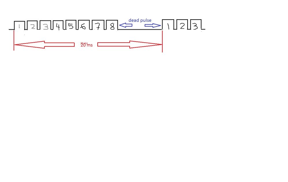

If i still talk about timers, i was wondering of a better solution to synchronize my pulse indexes.
I have put a picture bellow. My ppm signal is composed of 8 pulses with ranges from (500 to 2000uS) and pause between 8 pulses of aprox 300uS. The ppm pulse frames are sent with a rate of 50hz between each frame. and i thinked to declare a array like uint32_t pchan[8], and to asign to each pchan the number of the pulse index, example pchan[0] = pulse1, pchan[1]=pulse2 and so on... I was thinking of measure the time between the last falling edge of the current frame and the first rising edge of the next frame, and if the period is greater than a maximum pulse width (2000us), then consider for the next pulse, index should be 0. I am asking if there is a best solution for achiveing thisvoid TIM2_IRQHandler(void)
{ if(TIM_GetITStatus(TIM2, TIM_IT_CC1) == 1)// If compare capture has occured { TIM_ClearITPendingBit(TIM2, TIM_IT_CC1); capture1 = TIM_GetCapture1(TIM2); // Get timer counts for Period capture1 = capture1 -capture2 ; // get the Toff value between pulses if (capture1 >2000){ uu=7;} //if we detect the ''dead pulse'' reset pulse index if (uu>7) { uu=0;} // if the index reached maximum allowed index, reset it ! } if(TIM_GetITStatus(TIM2, TIM_IT_CC2) == 1) {// If compare capture has occured TIM_ClearITPendingBit(TIM2, TIM_IT_CC2); capture2 = TIM_GetCapture2(TIM2); pchan[uu]=capture2 ; }2015-07-05 6:03 AM
I'm familiar with PPM signals, and it's a topic that's been covered here before, several times.
You'd want to save the delta values into an array, along with code to confirm an ~20ms repetition rate, and to resynchronize the table. With thought DMA could be used to decimate the interrupt loading. Your code appears missing an uu++We’re moving the ST Community to a new platform to give you a better and more reliable community experience.
