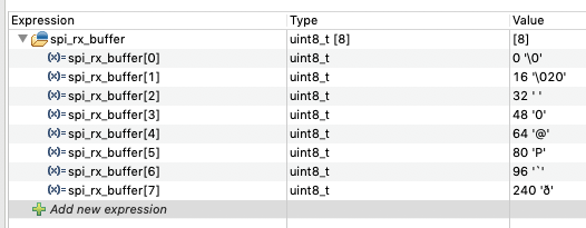

I'm trying out simple SPI comms between two STM32s. The TX is STM32F407 and the RX is STM32G070. The data that I seem to be receiving is different from what I'm sending. What am I missing here?
For the RX, I've set the NSS to software. I've configured the 'chip select' to be an external interrupt on the falling edge. In the ISR I receive the bytes from the TX. This is what the code for the RX looks like. SPI1 is configured as full duplex slave.

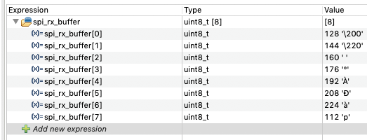

/* USER CODE END 3 */The data that I receive is as below,
2020-12-27 2:25 PM
Looks like your data is just shifted a few bits. Probably the receiver is not ready to receive before bits are sent, so it misses the first few.
Put a HAL_Delay(1) after you set CS low, but before you send data.
Also, ensure the slave SPI clock is at least twice as fast as the master clock.

2020-12-27 2:43 PM
That worked! Thank you for the quick response =)
