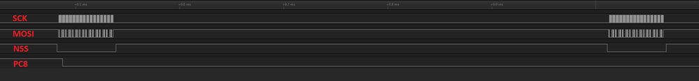

And here's an image of what I'm seeing when I run it (I have a separate SPI master providing data):
2016-05-05 5:18 PM
You write ''to prevent it trying to move data that hasn't yet made it to the SPI data register''. But the DMA will never do that. It only moves data as requested by the SPI peripheral, each time one byte is received. The DMA completion interrupt will only trigger once the requested number of bytes have been received, ie. 16 in your code.
In your SPI1_IRQHandler, you clear the RXNE flag. I think that is wrong, as the RXNE flag is what triggers the DMA, so you will lose the first byte. In fact, there should be no need to have an SPI1_IRQHandler at all. Just enable the DMA in init(), and wait for the transfer to complete and invoke the DMA handler. You do not seem to enable the clock for the DMA? With something like RCC_AHB1PeriphClockCmd(RCC_AHB1Periph_DMA1, ENABLE). This might be why your DMA interrupt does not trigger. Hope this helps, - Kristian.2016-05-06 8:07 AM
Thanks so much! I simply commented out all the code relating to SPI interrupts and added DMA_Cmd(DMA1_Channel2, ENABLE); to the end of the DMA interrupt routine, and now everything's working smoothly. I believe I could also just configure the DMA in circular mode to achieve the same result.
