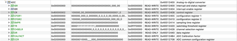

Read back and check/post the ADC register's content.
2019-09-02 2:16 PM
Thanks for the reply. I set bit 31 of the CR register (in line 4 of the code snippet above) but it just seems to stay in that state until I reset.
