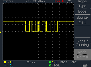

? -I tried the following piece of code:
timer16_config()
usart1_init(10400)GPIOA->MODER &= ~(GPIO_MODER_MODER0 << (0x0A * 2)) //Clear previous config of MODER
GPIOA->MODER |= (((uint32_t)0x01) << (0x0A * 2)) //Set MODER register to OUT mode//Wakeup Pattern
GPIO_ResetBits(GPIOA, GPIO_Pin_10) delay_nMSEC(25) GPIO_SetBits(GPIOA, GPIO_Pin_10) delay_nMSEC(25)GPIOA->MODER &= ~(GPIO_MODER_MODER0 << (0x0A * 2)) //Clear previous config of MODER
GPIOA->MODER |= (((uint32_t)0x02) << (0x0A * 2)) //Set MODER register to AF modeUSART1->CR1 |= USART_CR1_UE //Enable USART1
USART_SendData(USART1, 0xC1)
while(((USART1->ISR & USART_ISR_TXE) && (USART1->ISR & USART_ISR_TC)) == 0){}The above is the response I got on DSO.

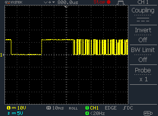

If say, I repeat the SendData command to the code,
while(((USART1->ISR & USART_ISR_TXE) && (USART1->ISR & USART_ISR_TC)) == 0){}USART_SendData(USART1, 0xC1)
while(((USART1->ISR & USART_ISR_TXE) && (USART1->ISR & USART_ISR_TC)) == 0){}I end up with this:
If I add the USART_SendData command to a while(1) loop, I eventually get my sequence, but that is after at least 100msecs
Eventually, after some time has passed:

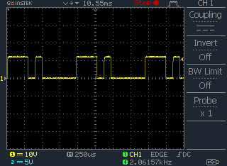

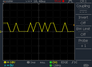

2018-07-03 6:56 AM
Hi
Waclawek.Jan
?,The only difference between the two images is that this is for
while(((USART1->ISR & USART_ISR_TXE) && (USART1->ISR & USART_ISR_TC)) == 0){} USART_SendData(USART1, 0xC1) while(((USART1->ISR & USART_ISR_TXE) && (USART1->ISR & USART_ISR_TC)) == 0){}while(1)
{// USART_SendData(USART1, 0xC1)// while(((USART1->ISR & USART_ISR_TXE) && (USART1->ISR & USART_ISR_TC)) == 0){}}while the following image: is for
// while(((USART1->ISR & USART_ISR_TXE) && (USART1->ISR & USART_ISR_TC)) == 0){}// USART_SendData(USART1, 0xC1)// while(((USART1->ISR & USART_ISR_TXE) && (USART1->ISR & USART_ISR_TC)) == 0){}while(1)
{ USART_SendData(USART1, 0xC1) while(((USART1->ISR & USART_ISR_TXE) && (USART1->ISR & USART_ISR_TC)) == 0){} }My GPIO config for USART1 remains the same as my original question. The MODER command works well when I converted from AF to OUT. However, OUT to AF is having the same effect as before.
The OD and PP configuration, while suspicious, is the only set which works for my external circuitry which converts the RX and TX into a single wire protocol. I needed the external circuitry because in another part of my code, I am also using the CAN functionality offered on the same pins.
