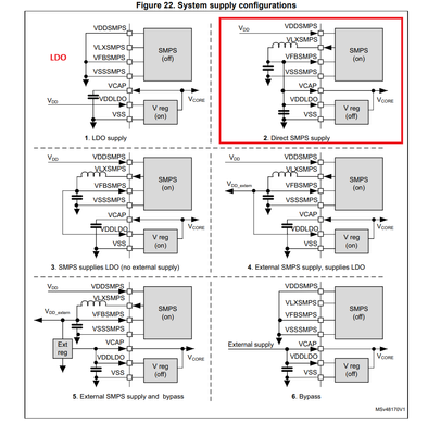

You need also that your hardware is configured in SMPS:
RM0399 / figure 22:
As LDO worked for you that means your hardware is configured in LDO.
Now, you need to recover your MCU as you programmed the MCU with the wrong power configuration. Read this article: How can I recover my STM32H7/STM32H7RS board after facing a power configuration deadlock?
