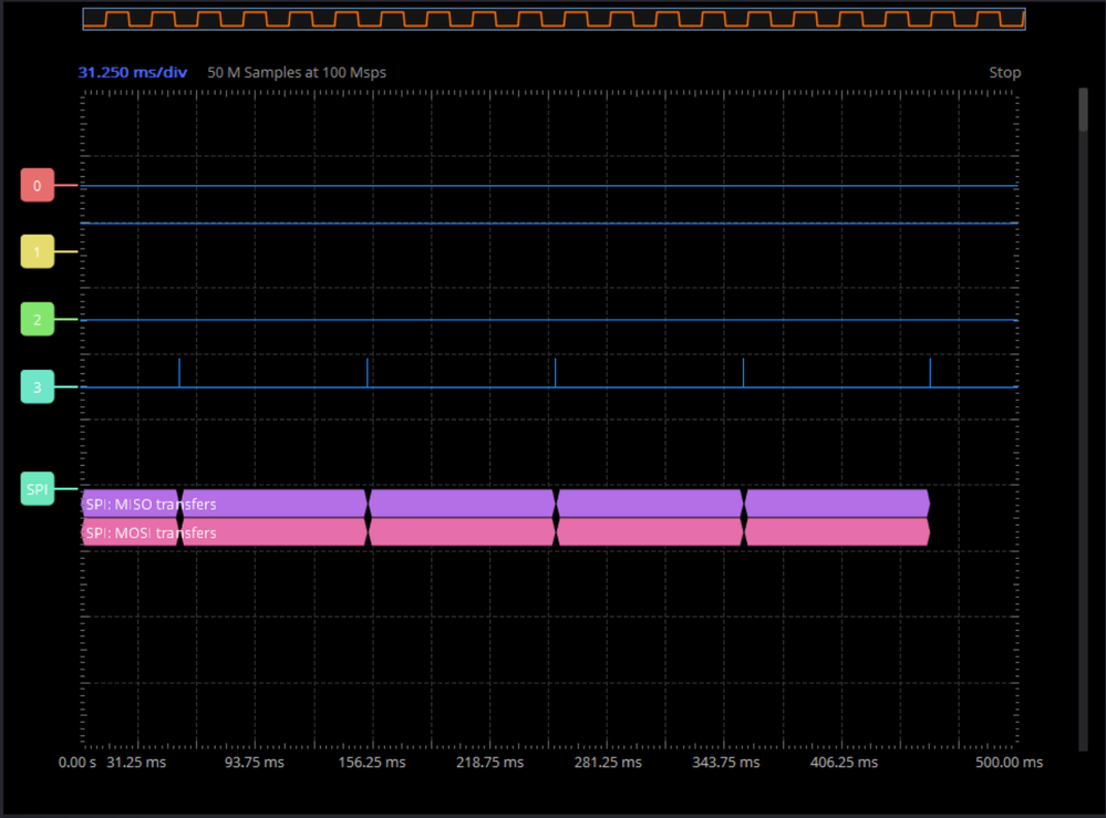

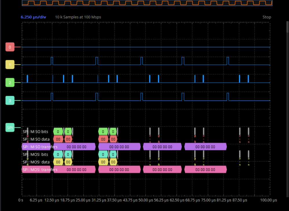

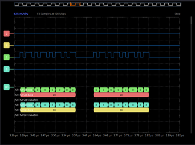

This was just to verify the SPI functionality. But when I observe the SPI Clk pin I'm not getting any clock signal.
The same code with the changed SPI handler (SPI 1 & SPI 3 both are working) in STM32L432KC nucleo board is working fine and I'm getting clock signal properly.
2024-03-06 1:29 AM - edited 2024-03-06 1:44 AM
These are the signals I'm getting for STM32L432KC :
The code used both the MCUs are same with corresponding SPI handlers.
