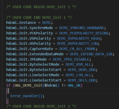

Here are the DCMI and DMA configurations I am using:
DCMI Configuration:
CopyEdit
hdcmi.Instance = DCMI;
hdcmi.Init.SynchroMode = DCMI_SYNCHRO_HARDWARE;
hdcmi.Init.PCKPolarity = DCMI_PCKPOLARITY_RISING;
hdcmi.Init.VSPolarity = DCMI_VSPOLARITY_HIGH;
hdcmi.Init.HSPolarity = DCMI_HSPOLARITY_LOW;
hdcmi.Init.CaptureRate = DCMI_CR_ALL_FRAME;
hdcmi.Init.ExtendedDataMode = DCMI_EXTEND_DATA_12B;
hdcmi.Init.JPEGMode = DCMI_JPEG_DISABLE;
hdcmi.Init.ByteSelectMode = DCMI_BSM_ALL;
hdcmi.Init.ByteSelectStart = DCMI_OEBS_ODD;
hdcmi.Init.LineSelectMode = DCMI_LSM_ALL;
hdcmi.Init.LineSelectStart = DCMI_OELS_ODD;
if (HAL_DCMI_Init(&hdcmi) != HAL_OK)
Error_Handler();

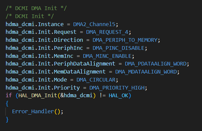

DMA Configuration:
c
CopyEdit
hdma_dcmi.Instance = DMA2_Channel5;
hdma_dcmi.Init.Request = DMA_REQUEST_4;
hdma_dcmi.Init.Direction = DMA_PERIPH_TO_MEMORY;
hdma_dcmi.Init.PeriphInc = DMA_PINC_DISABLE;
hdma_dcmi.Init.MemInc = DMA_MINC_ENABLE;
hdma_dcmi.Init.PeriphDataAlignment = DMA_PDATAALIGN_WORD;
hdma_dcmi.Init.MemDataAlignment = DMA_MDATAALIGN_BYTE;
hdma_dcmi.Init.Mode = DMA_NORMAL;
hdma_dcmi.Init.Priority = DMA_PRIORITY_HIGH;
if (HAL_DMA_Init(&hdma_dcmi) != HAL_OK)
Error_Handler();
__HAL_LINKDMA(&hdcmi, DMA_Handle, hdma_dcmi);

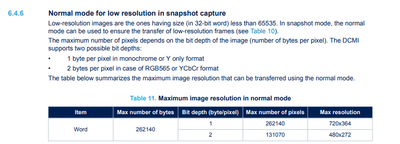

What is the image resolution?
Could you try with a low image resolution like 480x272?
I recommend you to take a look at AN5020 may help you.
Thank you.

DCMI configuration:
VSPolarity = DCMI_VSPOLARITY_LOW
DMA in circular mode with word alignment

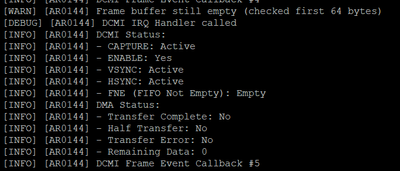

The issue is that while we're receiving data (the buffer gets filled and the frame callback triggers), the image data does not appear to be valid. We're getting base64-encoded output, but it doesn't decode to a recognizable image.
Our debugging logs show:
The camera initialization completes successfully
DCMI and DMA are configured correctly
The sensor goes into streaming mode
Frame events are triggered and our callback executes
But the resulting data appears to be corrupted or improperly formatted
Please have a look at the received data attached.

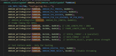

I have made progress in my AR0144 integration and moved past the PLL lock issue.
Current Issue: Frame Buffer Remains Empty :
Please check the log file that i have attached along with the DCMI DMA configs.
Also i am keeping the ar0144 initialization setting since i have added changes to overcome PLL not locking issue.
