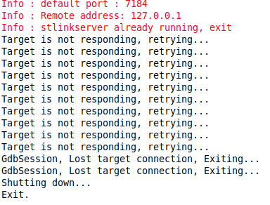

We are currently working with a custom board that uses the STM32H745BIT6 MCU, and we are attempting to connect it to the STLINK-V3SET debugger. However, we are experiencing intermittent debugging issues described below:
The debugger successfully enters debug mode only 2–3 times when done the first time.
In most cases, the debugger connects and enters debug mode, but after approximately 6–8 seconds, it displays a “Target lost” error (please refer to the attached photo).
Often, it shows “Target not responding.” When this happens, we need to power cycle the board. After turning the power supply off and on again, it behaves as described in point 2.

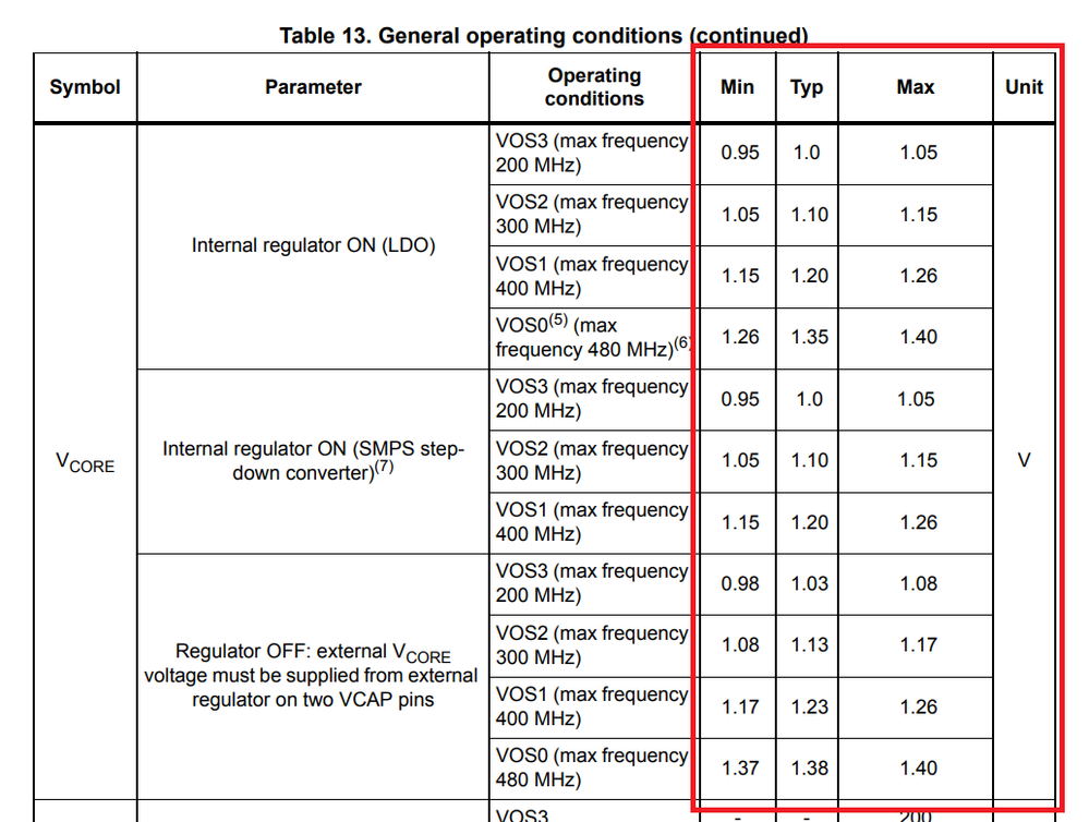

Check the VCORE voltage level versus the VOS you set and the power supply config in your software versus what is provided in the datasheet:

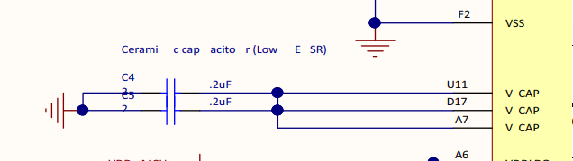

Measure VCAP voltage with an oscilloscope and check if there is a glitch / voltage drop.
2026-02-24 5:13 AM
This is likely a hardware design problem.
Why are there two grounds?

I checked that with the hardware team, that is no issue.
