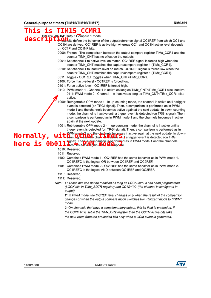

Look at it again, it's right there, just the indent is wrong.
2019-11-18 2:22 AM
Oh.
Indeed.
Thanks, @berendi .
Then, the indent should be fixed... :)
Jan
2019-11-18 2:44 AM
Ok, this noted for fix.
Thanks,
Imen
