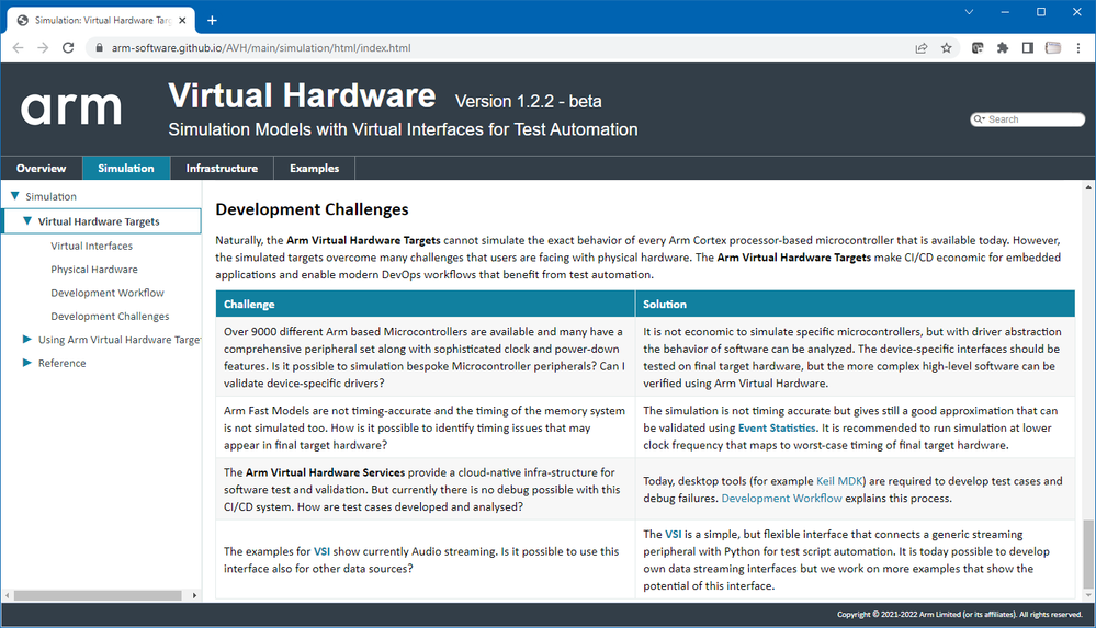

Recently ARM advertised their "virtual hardware". Maybe, this.
2022-06-06 3:31 PM
Interesting - although still not a complete, timing-accurate simulation of a specific microcontroller:
https://arm-software.github.io/AVH/main/simulation/html/index.html#Development_Challanges
