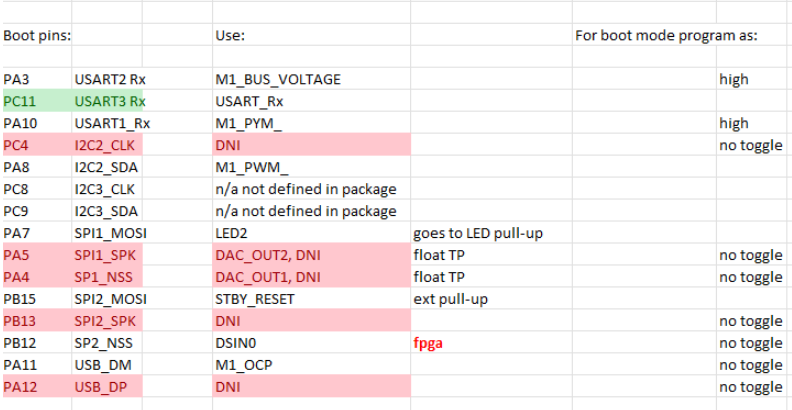

There are a number of pins used in boot mode that must be dealt with if those modes are not used. The following table lists the pins and their function:
The USB pin, DNP, on PA12 is a DNI pin and in user code is initialized as a analog with a pull-down. However, in boot mode it is evidently being falsely triggered. Adding a pull-up external to the board allowed the MCU to boot properly into the bootloader. In the list above the right hand column lists 9 pins which must have no toggle or be in a high state to work. This is required in boot loader mode and hence independent of how user code initializes the pins. For now, disabling the user signal dsin0 on PB12 during boot loader mode and adding a pullup on PA12 allows the bootloader to work properly.

Thanks for sharing this. The "don't touch" pins in bootloader is a tricky issue, and I know of no good detailed analysis of this out there.
