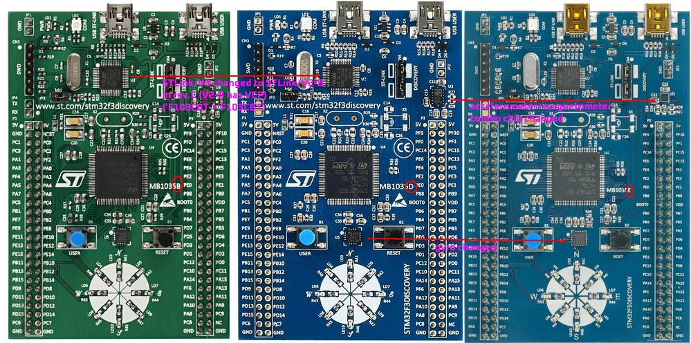

2022-08-04 4:44 AM
Good to know I'm not crazy. My boards are rev.E and I do see the physical difference from hardware in the demo videos. There is just one device where there used to be two.
This revision is billed as a direct replacement but now I wonder, does the magnetometer even exist?
2022-08-04 4:54 AM
As I've said I don't have the board. But based on what I see in the published schematics and also the manual, I don't see reason why wouldn't be one of the two devices (we are talking galvanometer, and the accelerometer+magnetometer combo chip, are we?) populated.
Show.
2022-08-04 5:04 AM
2022-08-04 5:56 AM
Exactly.
The User Manual says the function still exists, I'm just going to have to learn how to program it. Fun, but not on the schedule...sigh. I gather there is onboard editing, maybe I can just change a device selection or something in a configuration file.
Thanks for the assist.
